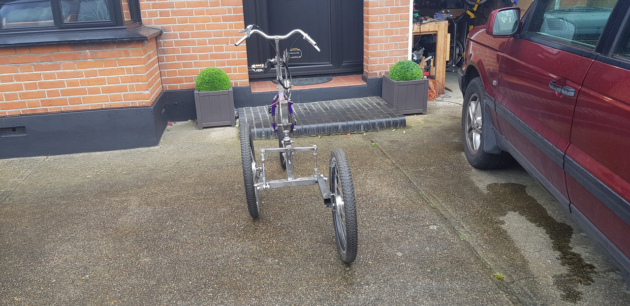

Another FWD Delta trike.
3,180
Today we had a play at pseudo-I-Leaning the Delta by putting one wheel Fwd and One wheel aft.
While it would stand up, one puff of breeze, slightest touch, it still collapsed in a heap and did not appear essentially any more stable/less prone to falling over than with both wheels in the "trailing arm configuration.
It may be that I have used alcohol infused steel and it stands no chance of standing up straight unaided ;)
3,247
A brave attempt , however you need to go one stage further ?
Lengthen the vertical connectors till you have the biggest angle you can get between the 2 trailing arms [ 90' is ideal , however less may work ?]
It wants to look like this :-
3,180
Le Canard est Mort!
I have decided to go in another direction with this.
