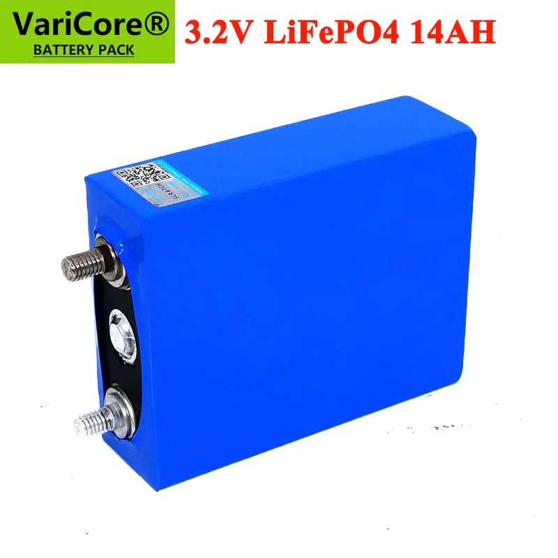

So i'm thinking of going electric with the TongSheng TSDZ2 36V 250W.
Battery wise I am also thinking of DIYing it. After looking around these Vicore LiFePo4 15aH cells look like a good buy at small money
I have searched a good bit and it seems that these cells deliver just about what they claim in terms of capacity. I have decided that LiFePO4 is the way to go in terms of safety and lifetime. Price wise this is going to be about €100.00 for the cells and then about another €30.00 for the BMS. The only unknown is the cost of a half decent case which will have to be custom for these cells.
So my question is, has anyone else gone down this path and if so what was your experience. Off the bat I have no issue with using AliExpress for components, but feedback on individual sellers is always useful.

Do you know the C rating of the cells? The Chinese are notorious for claiming any amount of capacity for their cells so only trust any independant reviews and tests you have read.

I have seen a few people with batteries from the same brand doing reviews. they either report spot on AH capacities or slightly under. As to C ratings I would have to check a bit more. Whats a typical 250Watt motor pulling at peak ?

It seems that they now do a 25AH cell which is almost the same size, but these 14AH cells are no longer listed on the Varicore store. This seems to indicate that these are old stock which is coming from resellers. For about another €70.00 you can get nearly the same size pack with an extra 10AH which is still a bargain. Watching some of the solar vids on these packs there was a significant jump in energy density about two years ago which came as a surprise to the testers.

The first battery is 18A 30second draw, 12A continous which might be a bit marginal.
The 25AH battery has a continuous discharge of 50A and instantaneous of 100A.
So in every way the 25AH is the better product with an increase of height of 3cm and weight of 150g for 500g per cell, all for just €170 on the total battery. Even if its down 20% on AH spec its still a steal.

All great info people. I think I will pull the trigger on the 25Ah Variocore's. The only thing I don't like is the move from terminal posts to flat terminal pads. I was hoping not to have to bodge together a spot welder and I really don't like the idea of spot welds taking that much current.
i have seen the 14Ah ones described as 15Ah, so I think they are probably derated from original specs because they are old stock - you might be surprised and get the full 14Ah.

This basically looks like a repackaged version of the 25Ah cells, about 5cm taller so not exactly the same and might suggest that the Varicore ones will come out at 20Ah or there abouts.
