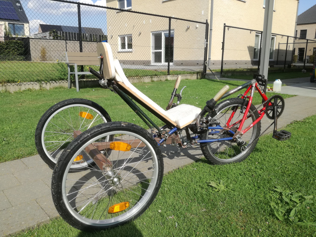

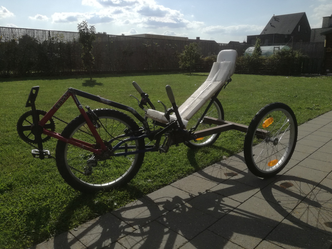

Hi everybody,
I had some leftovers from my tadpole build and thought to give it another shot. I ordered m14 rod ends at my friends Aliexpress and assembled the python trike in the attached pictures.
The front is made of the rear of two kids bikes. The rear wheels came from a second hand sale (15 euro for both complete wheels) and were meant to be used for a trailer.
Adjustable seat (more some scrap wood and packaging foam) and handlebars. Pivot angle 61 degrees. Fun to build, fun to ride. Quite a large turning circle if I keep myself in the middle of the seat. If I move my buttocks halfway in the direction of the bend, I can easily turn around the small fruit trees in the garden.

The rear wheels have 12.7 mm (1/2 inch) axles. I don't suppose these were made for rough journeys or for carrying heavy loads (I weigh 75 kg). That's why I placed the word "experimental" in the title. I love the odd way the python controls along with the compactness of the design. Until now I only used the bicycle in our garden and in the street.
I fear that the seat is too high and the wheel track too narrow to drive safely fast. When you are 65, speed is not the most important thing in life.

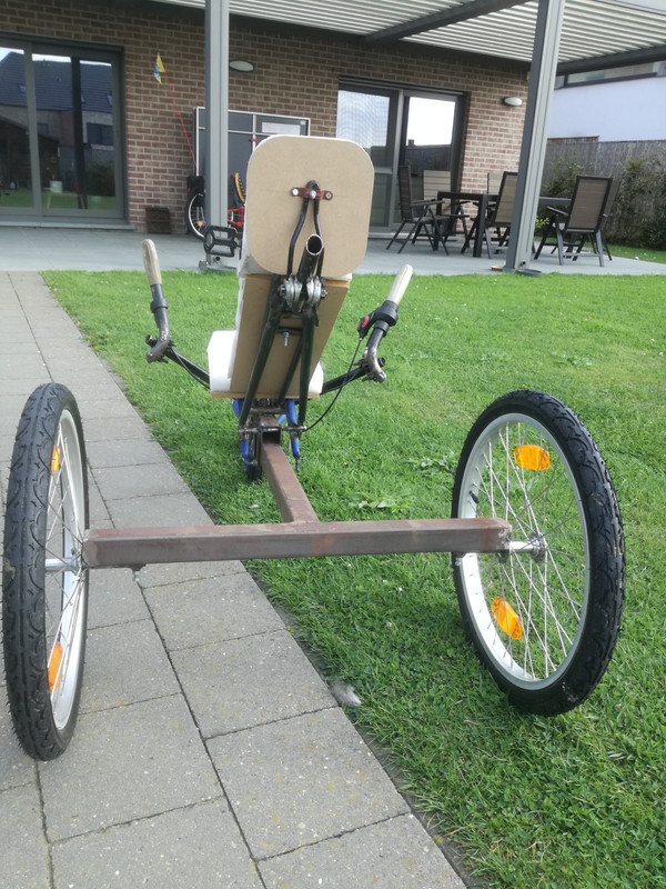

Yours looks to have a seat height of 14" [ 35cm ] what is the rear track ?
Mine has a seat height of 8" [ 20 cm ] and a rear track of 30" [ 76 cm ] at speeds above 9 mph [ 14.5 Km ] a sharp 90' turn will lift one wheel.

Thanks all (Brad, Sir Joey, Paul) for your replies. I appreciate your comments and suggestions concerning my build. Thumbs up for the Atomic Zombie Community.
The seat height is 40 cm, necessary to turn above the pivot (and easy to get on, easy to get off). The rear track is 69 cm. This gives me some play when driving the python in the garden shed without having to open the second wing of the door. The combination of these two dimensions makes it more of a grandpa's hpv rolator than a speed rocket.
Is this because the front hits the rear frame when turning ?
The front can turn up to almost 90 degrees. So the trike (unloaded) can turn on the spot. The inner back wheel stays in place.
When sitting in the seat, my hips seems to be not flexible enough. Apparently it is hard to move the seat sidewards and upwards to make a tight turn. Moving my buttocks left or right helps to push the central pivot sidewards and allows a more tight cornering.
Is that outer to outer ?, tyre centre to tyre centre ? tyre inner to tyre inner ?

Belgium
The track is measured centre to centre.
My angle is closer to 56' maybe if you tweaked the rod ends you could reduce your angle a bit ?
Initially I build it with the 'ideal' pivot angle of 65 degrees and lowered it after I read your discussion with Pegasus here on the forum.
