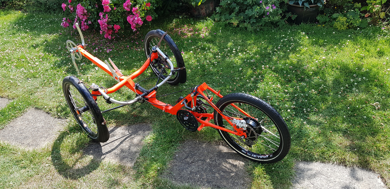

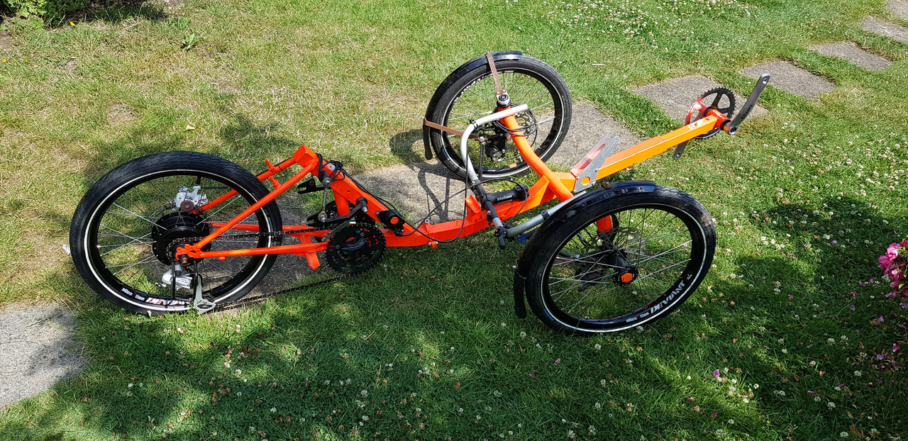

Hi Folks,
I am trying to finish what John began with his second folding frame. His first one (NICOR) is alive and well and providing me with lots of fun.
This one, he had named "LOKI" and while I have now located the Bafang 8-Fun and batteries that John had intended to place on this one; for now I shall keep them in reserve (in the first instance) and I will be building it up as a non-e-assist folding trike.
I have added the rear wheel with a Nuvinci N380 in place of the 48-spoke 7 speed cassette equipped wheel that was on there as a rolling frame.
I suspect that this will be a Winter project as I have NICOR to ride this Summer/Autumn.
That is all.

Nice looking ride so far.
With the original rear triangle used like this, seems it would be easy to just swap that one our for a suspension version.
The jackshaft / crossover makes this super easy.
Brad

The design of the rear end would not allow the easy replacement to a swinging unit as the whole triangle is cut and welded to the main boom.
3,177
Indeed, she be a hard-tail and very much designed to remain that way.
I could mess with it (of course) but I am ok with it as it is because it folds quite well and is readily transportable in the back of the car.
There are other challenges but I will sort them out as I go along this Autumn/Winter.
