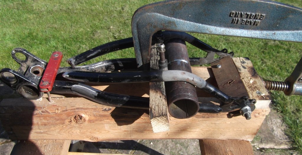

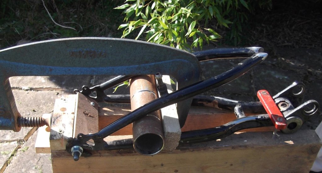

This is a standard MTB rear frame for 20" wheel , hopefully it will be repurposed as a Flevo/Python trike hybrid [ really need to find a name for it as that is very clumsy :whistle:;) ]
The plan is to heat it where crosses the 2 stunt pegs and bend each leg down as close as possible to the red bar ...
Simples you say ? well 5 minutes latter with one plumbers torch we had not even caused the paint to bubble.
So we used 2 torches and a few minutes latter it worked , the first one spread a little at the bend the other was faster and better and neither split which was my big worry.

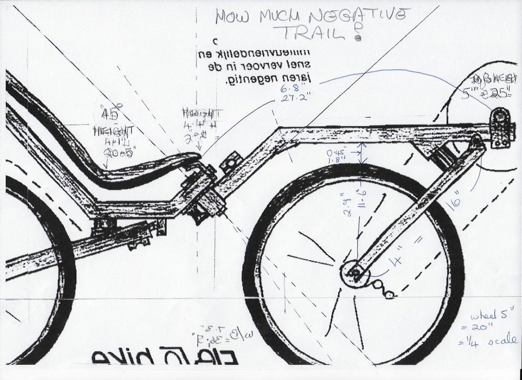

3,141
Whoa we are moving into uncharted territory here ~?
The Flevo trike/bike has strange handling [ rather than a Python ] because of it's steering angle [ green line ] and resulting posotive trail ?
So to Pythonise it I wanted to build in my Pythons 56' [ red line ] and 20 cm of negative trail [ blue line ].
That moves the steering pivot back quite a bit .....
What is the result of that ? not sure ?

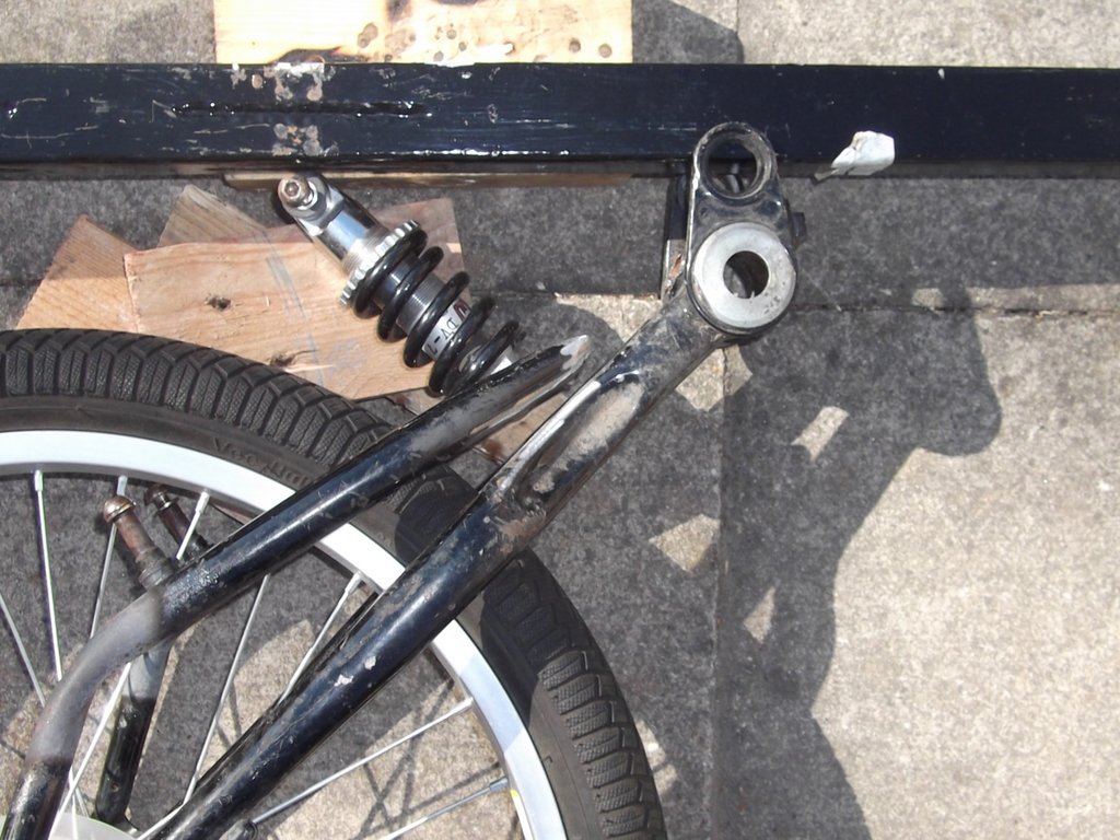

Other days task ?
looking at the new builds front end ?
So I need to try and get a suspension shocker in the front end , at right angles to the front fork [ the whole rear end of a MTB bike ] , and @ 45' to the main frame shown arcing across the front wheel.
As can be seen the pink bracket is way to deep and the yellow pivot spacer tube can also loose a bit maybe ?
The two loose upper frame parts [ seat stays ] need trimming and squeezing down to meet the chain stays that will create room for the shocker.
I think the lower mounting can be a tube through or half recessed in the chain stays , however this shock absorber has very little travel ? [ as can be seen in the picture ] maybe less than 2cm does this matter ?
