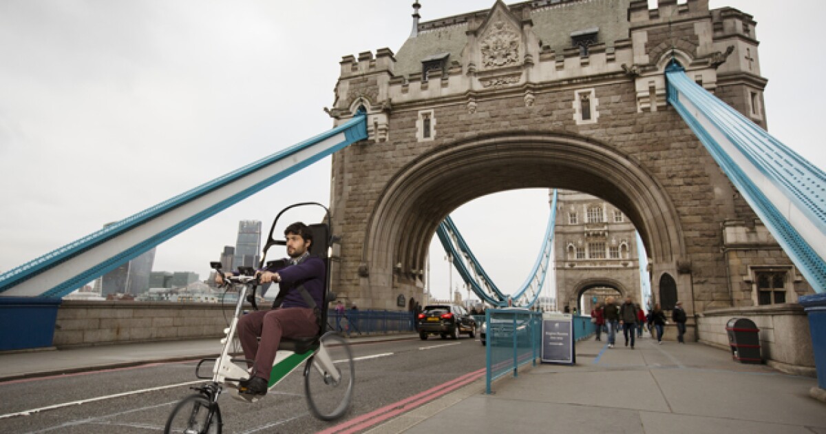

Here is a version for a bike
These are not an item that is readily for sale in the United States.
The first link is from an Australian vendor that will sell a trike with a roll cage. I have not seen one that can be used with existing commercial trikes.
I think there might be some demand for something like this. I've seen a guy on youtube that fabricated his own roll cage-but he did this by eye-- he had no formal plans.
I wanted to see if anyone shares my interest in such a product.

The babel bike roll cage (the 2nd link) was crash tested with an idea of protecting cyclists from collisions with autos/trucks. They also strap the rider in. That was discussed in other links. That bike is not being sold any more.
You may be right that the trike roll cages were not designed with auto/trike collisions.

I didn't read all the details, but I thought the 2 wheeler with roll cage seemed immediately a bit funny. Who is so scared that they need a roll cage but still happy to ride a bike with one? What madmax death roads are you choosing to ride on?
The infomercial in my head.. "Are you sick of being run over by trucks? Well we have a product for you!"
I'd rather wear a motorbike armoured jacket and i think that'd be more useful in most common cycling accidents.
Maybe if you're downhill mountain triking then a roll cage could be an idea worth looking into.. otherwise It seems a bit strange to me.

Well the babel Bike was not a big hit, so you may be correct. I posted it here because i liked the concept and thought the bike roll cage might have a broader appeal as an add on for existing bikes.
The sister of a friend of mine had a nasty bike accident in Portland--a fairly bike friendly city. She is now paralyzed from the neck down. I suspect had she been using a rollcage seat like that one, she would not have had that problem.
It seems to me like a roll cage seat like the babel bike is fairly doable project. I'd like to hear others thoughts on that.

The rollcage is tried earlier, but failed.ecause it created other problems. That is why other people that tried it, stopped developing them.
I wouldn't feel safe ad all, strapped into a seat on a bicycle. And on my trike, I don't see the value ad all for safety outside racing like they do in Australia. As I ad something like that, I would use it for a body mount.
This roll cage only gives a fake feeling of safety, just like a bike helmet.
It is nice that you want to protect yourself and others. But this isn't helping ad all. It makes it only more dangerous.
As you want yo be safe, ditch the helmet and learn to accept that you are vulnerable on a bike and ride like that! It us proven to be way more safe.
